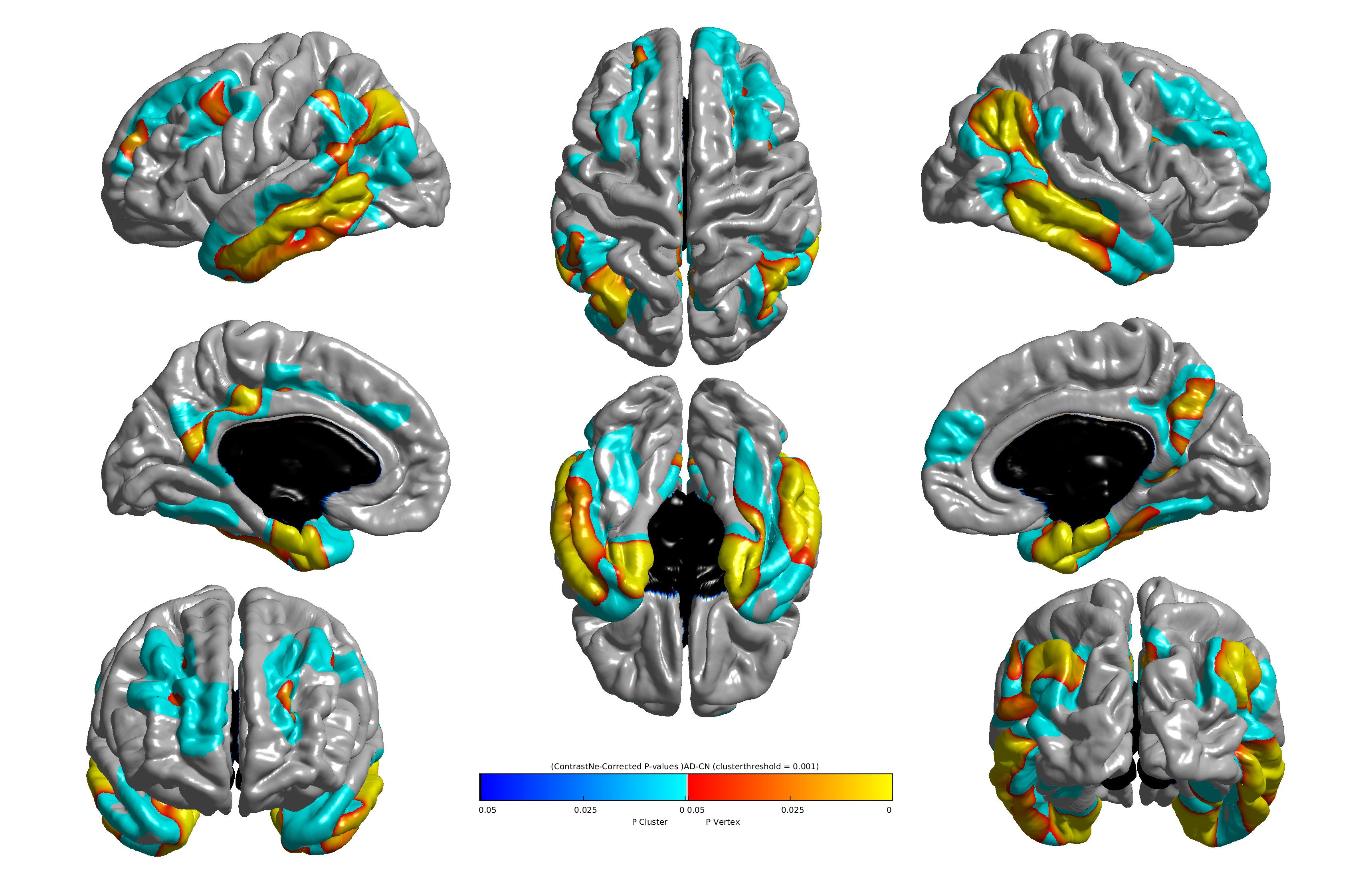

The JPEG files are simple snapshots.
The *.mat files can be read later by tools like PySurfer and Surfstat.

Group comparison between patients with Alzheimer’s Disease (group_1 = AD) and healthy subjects (group_2 = HC).
ADvsHC defines the group_label.

The example image here maps statistically significant differences in cortical thickness between a group of patients with Alzheimer’s disease and a group of healthy controls (yellow: correction at the vertex level; blue: correction at the cluster level).
