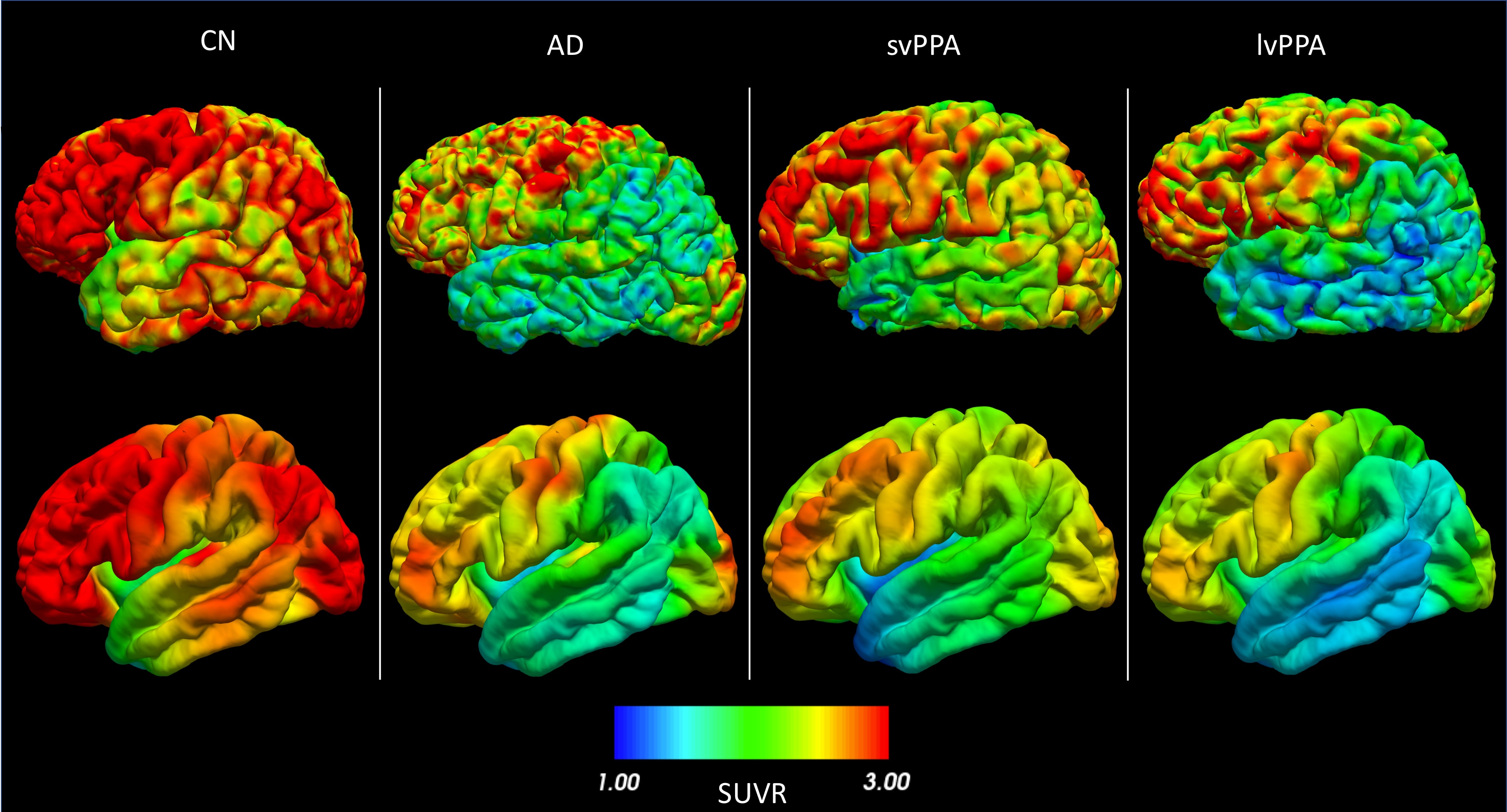

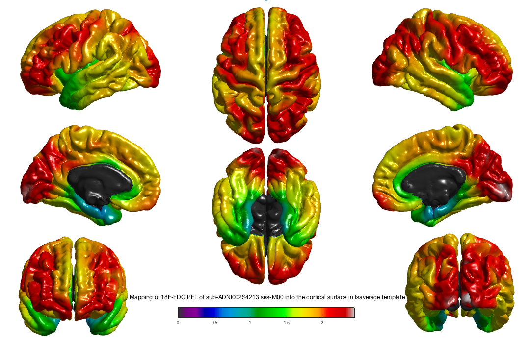

PET surface results
FDG PET SUVR projected onto the cortical surface (left hemisphere) for (from left to right) a cognitively normal subject (CN), a patient with Alzheimer’s disease (AD), a patient with semantic variant primary progressive aphasia (svPPA) and a patient with logopenic variant primary progressive aphasia (lvPPA). The first row is the projection in the subject’s space. The second row is the same signal for each subject, but warped to FsAverage after smoothing with a 20 mm Gaussian kernel.

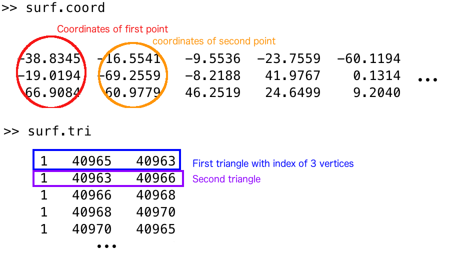

Surface file
Surface files can be read using various software packages. You can open them using freeview (FreeSurfer viewer), with freeview -f /path/to/your/surface/file.
You can also open them in MATLAB, using SurfStat: mysurface = SurfStatReadSurf('/path/to/your/surface/file'). This will give you a structure with fields coord (for coordinates), a list of coordinates for each point of the mesh, and also the field tri (for triangle), a list of triplet for each triangle, each number representing the Nth vertex of the coord list. Below is an example to make things clearer (read with Matlab).

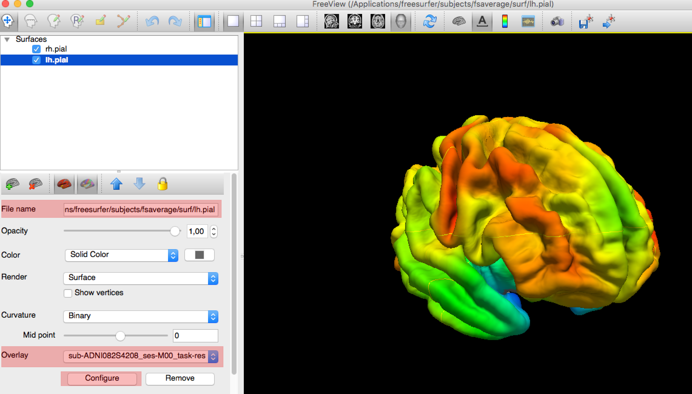

Visualization of the results
After the execution of the pipeline, you can check the outputs of a subject by running this command (subject moved into FsAverage):
freeview -f $SUBJECTS_DIR/fsaverage/surf/lh.pial:overlay=path/to/your/projected/pet/in/fsaverage/left/hemi \
 -f $SUBJECTS_DIR/fsaverage/surf/rh.pial:overlay=path/to/your/projected/pet/in/fsaverage/right/hemi
