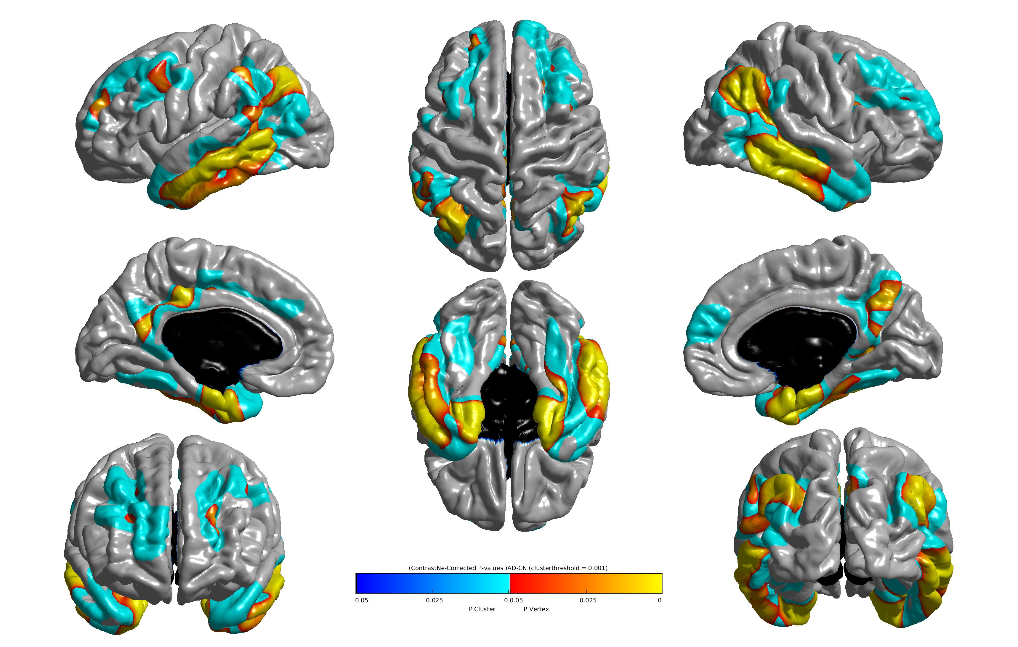

The results of the group comparison between AD and HC are given by the group-ADvsHC_AD-lt-HC_measure-ct_fwhm-20_correctedPValue.jpg file and is illustrated as follows: Corrected p-value map
Visualization of corrected p-value map.
The blue area corresponds to the vertex-based corrected p-value and the yellow area represents the cluster-based corrected p-value.
