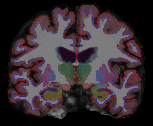

– FreeSurfer-based processing of T1-weighted MR images¶
This pipeline performs cortical surface extraction, segmentation of subcortical structures [Dale et al., 1999], cortical thickness estimation [Fischl and Dale, 2000], spatial normalization onto the FreeSurfer surface template (FsAverage) [Fischl et al., 1999a], and parcellation of cortical regions based on different atlases [Fischl et al., 2004], using the FreeSurfer recon-all
command.
Additionally, from the FreeSurfer outputs, we generate TSV files containing a summary of the regional statistics (e.g. regional volume, mean cortical thickness) to ease subsequent statistical analysis.
